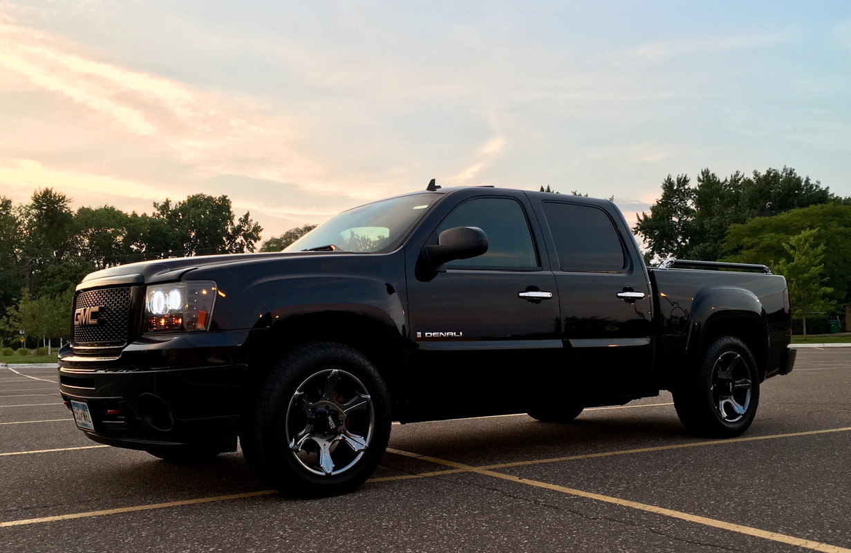

This is what it used to look like:
Here it is today (dirty):

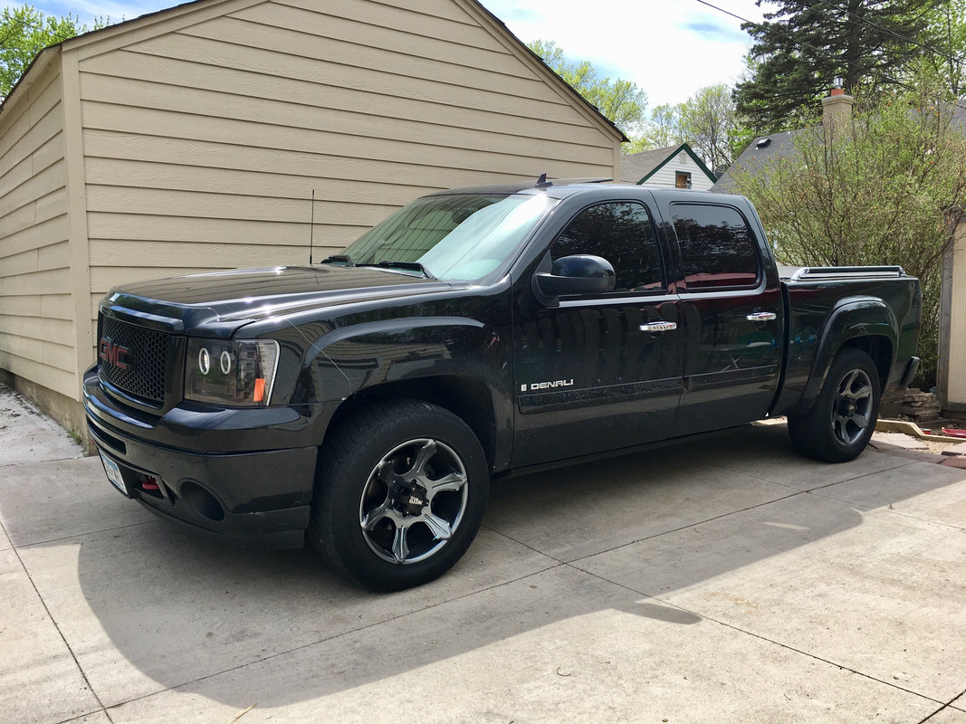

Here's a rundown on the front.
Hard to see from the first pic above, but the previous owner had a Westin deer smasher guard on it which meant the geniuses that installed it cut holes in the factory grill.
The first thing I did was take that thing off and sell it on CL. Then used the funds to buy the black one as seen ($72 on Amazon after months of patience).
Then I wrapped the upper trim piece and lower grill in Vvivid vinyl to color match.
There was also a nice rust spot on the driver's front edge of the hood, which I ground down, repainted and then covered with an AVS Aeroskin to hide it.
The original GMC badge was toast after 10 years and the "M" actually fell out one day, so I bought a new one and painted it as well as the tow hooks. Turns out a $3 can of "Burgundy" Rustoleum was about as close to "GMC red" as I could find.

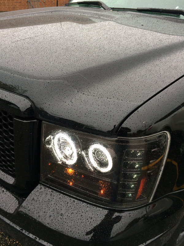

Headlights are Recon with Beamtech LED's. Forgot what the floods are; just some cheap $20 plug n plays you can find on Amazon. It's mainly for the "cool factor" as I rarely drive at night
See less See more
If you've been on the fence about using a silicone-based paint sealant, then this is a visual for you.
This is rainfall on a fresh coat of Wolfgang 3.0. No, it's not "hydrophopic" in the sense that nothing will ever stick to it - like water, dirt, snow, etc - but it really does last a long time. I'm anal and wax over it, but it really is worth the investment.

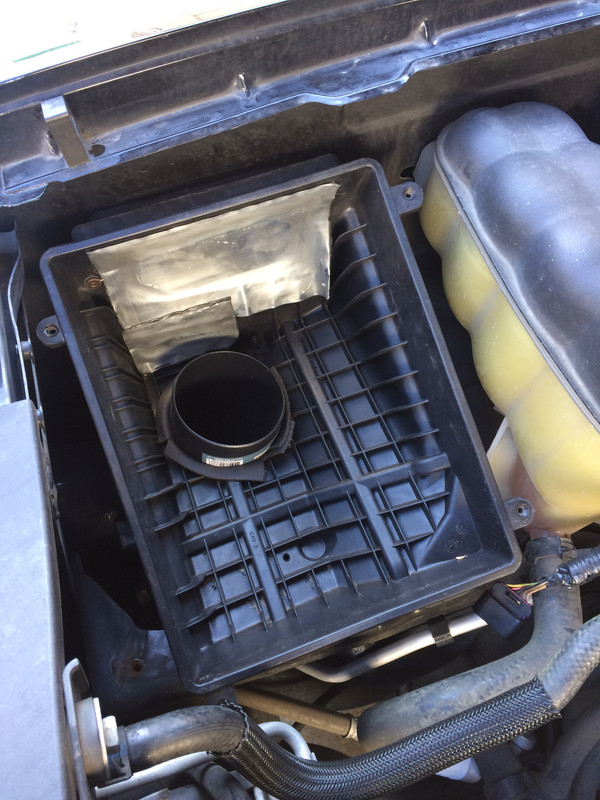

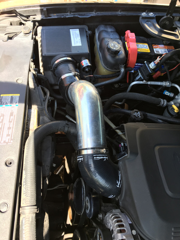

But what about the intake? Surely that beast sucks the coldest of the cold air and has been properly modified to do so? The only thing it's missing is a fan!!! :lol:
I bought some cheap parts from the hardware store, eBay and Amazon as well as a used air box and went to town.
I really hated the old plastic monster manifold, plus without a catch can it was getting blasted with oil mist and collecting in the low points and pods. Screw that thing.
There are two 4" 90* elbows that fit together and source air from behind the headlight. The fender hole is sealed off because the truck didn't like it open (made a weird clicking noise on accel).
To do that, I had to remove the tray the air box sits on and bolt it directly to the truck. It actually fits that cut out perfectly. Go figure.
I just replaced the factory PCV breather with 3/8" tubing and plugged it in after the MAF.
No it didn't give me any more power.
No it's not louder.
No I didn't gain any MPG's.
That is all.

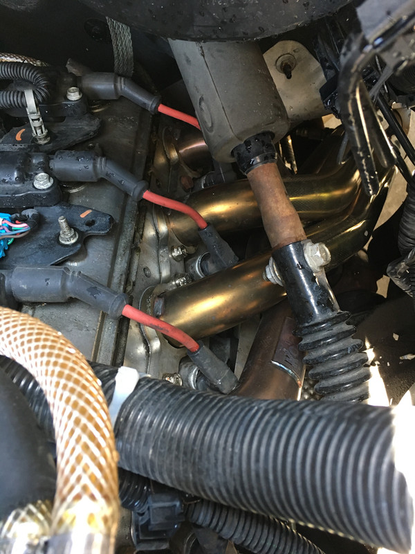

No I did not put that last screw in on the pass side coil pack next to the firewall. And you can't make me!!!
