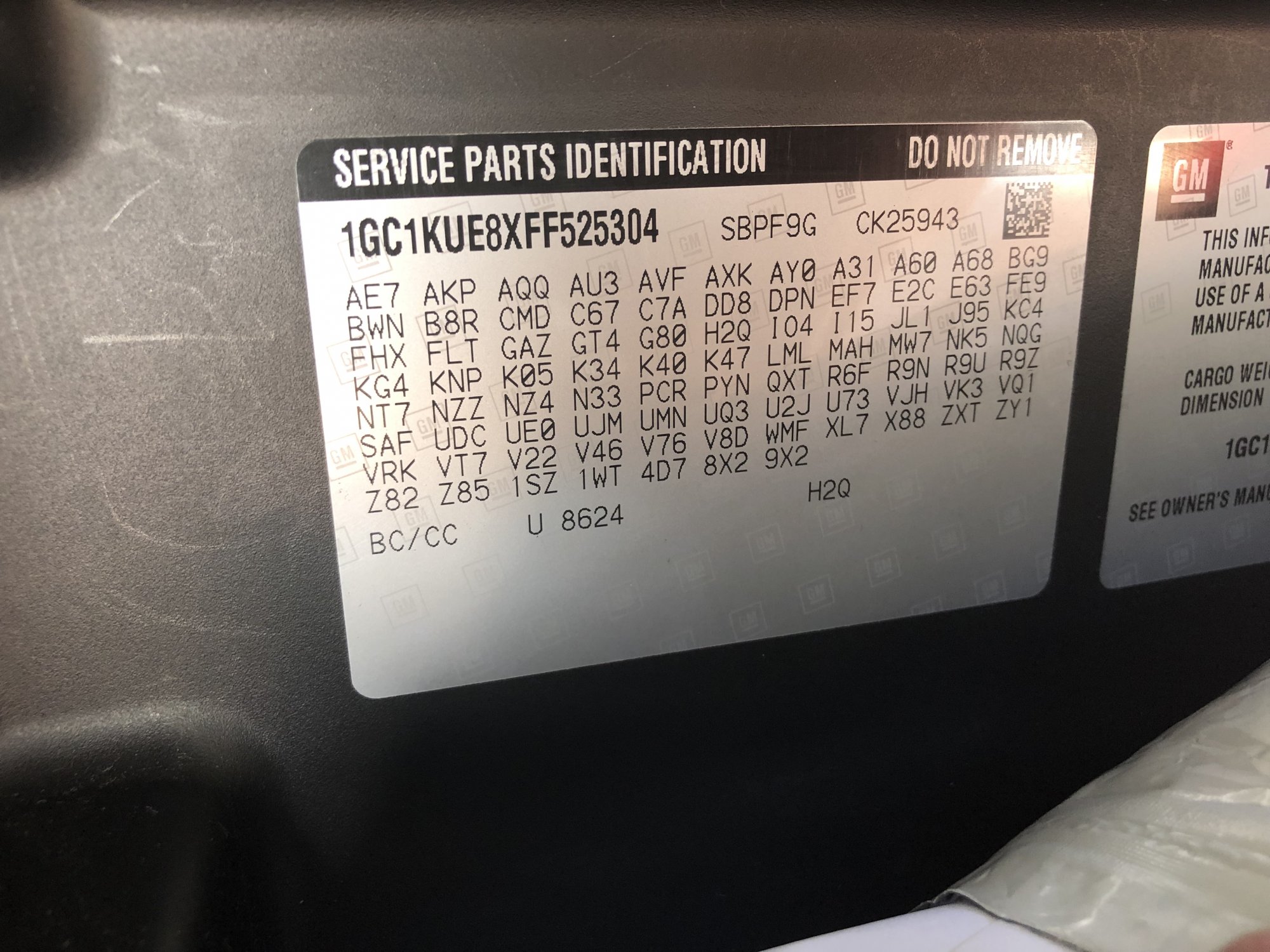

I know there are threads on this but wanted to provide the part #s I used to add a heated steering wheel. Some trial and error was involved to get the correct parts . I bought the harness (from clockspring to left fusebox) from HarnessDr as my truck was not equipped. My airbag had 2 connectors ( some had just 1 )
OE Steering wheel # 84483768 , Black leather
OE Clockspring # 86599259
