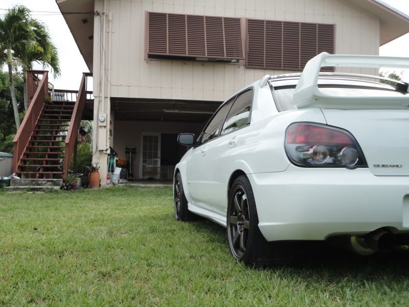

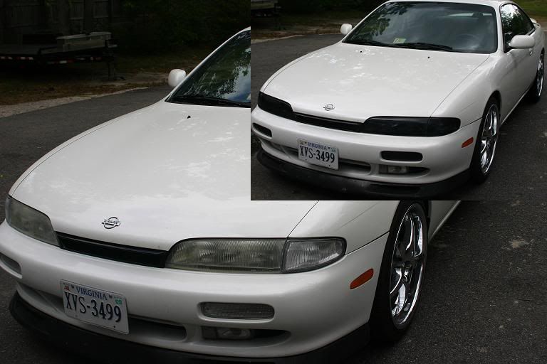

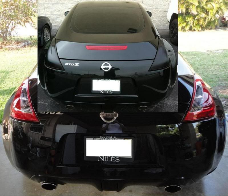

hey guys i am new to the forum but veteran to tinting lights, I would like to post some VHT pictures but there not Sierras or Silverados but these are all tinting with VHT nightshade so it fits suit. Also in your write up you did an initial wet sanding before applying VHT, I have never done that i always clean with alch. then apply, and if any one messes up a layer perhaps a run or just too thick let it dry and try to wet sand it out before you completely strip, it might save you some time and a few dollars. Your's looks good i never did the final clear i always left them because i liked the color with out clear... now i will post a few pictures of cars i have done, i have done VHT and stripped it off for several years i am pretty good with it and will answer any questions you may have. By far this is the best write up i have ever seen for a VHT tint process very well done sir!!!
my old subaru- 2 thin coats

my old 240sx head lights- CANS of VHT were used i ended up stripping it all off to sell it but i rocked it for months ( couldn't drive at night it blocked all light)
and a guy i work with asked me to do his 370z really dark

It all depends on how dark you go, my Subaru sti with 2 thin coats you could not even tell it was still so bright, but if you murder them out like i did the front of my nissan 240sx up there, you will have no light shinning through which is followed by tickets. The good thing about VHT is that it doesn't cost much and you can take it off like it never happen! Like i said i never did the initial sanding like the author of this great write up did, so that if i did strip it down you'd never notice and you couldn't when i did strip it off, another + is that you can do 1 coat test your lights do another coat test your lights until you get to the shade that you want for you vehicle.

Thank you! That black 350z you posted up looks amazing.
