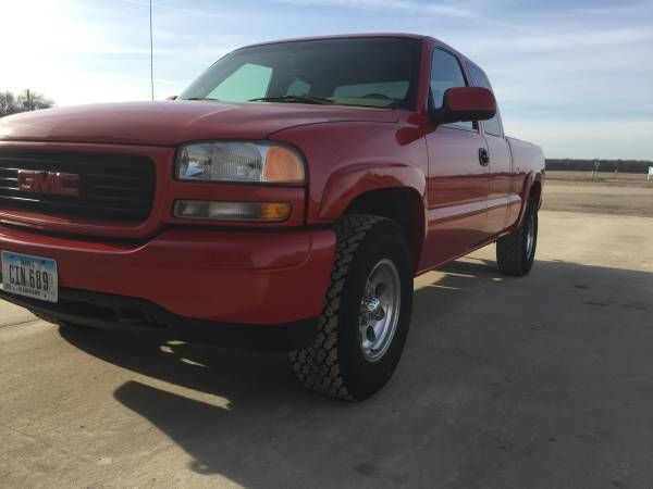

I test drove a couple tahoes and a couple silverados before I found the one I purchased today. Both silverados I drove had the what I know now is the notorious 5.3 tick on start up. The 2001 gmc sierra is no different. It has 106k on it and is real clean. The guy I got it from said it only does it on cold starts and goes away as you drive. What have you done to remedy this? Better oil? Synthetic oil? Diesel oil? (Only thinking this because of the zinc that diesel oil has)...Lucas additive? It also has the gas gauge that does as it pleases. Any tips or what to expect from the truck? I feel for the year and the miles i should have a good truck for a long time
