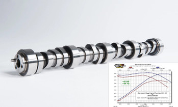

If it makes a difference, it's a late 2011 2wd. The AFM stuff was ripped out years ago, going to delete VVT and put in a slightly hotter cam. A stage 2 Brian tooley Still just gonna be a daily though.
