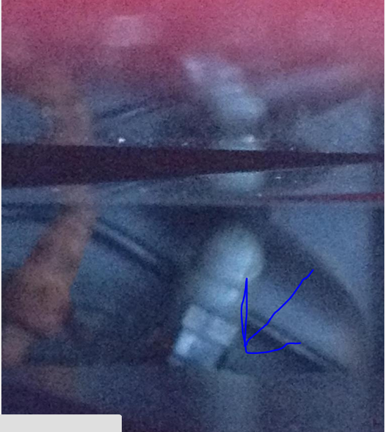

I think I have a similar issue and just updated a post from last year that I started. It got real when it was overflowing from the top of the tank. There are two lines that you can see between the bed and the cab. Are these the lines you have issues with? I am trying to figure out what it is called.

Yingpin... I haven't actually been under the truck to see the lines that were leaking along with the fuel pump. I do believe from my mechanics explaination, that those are the two lines though. I'm having my lines replaced with new poly-lines. They are using them now on other vehicles and are DOT approved. I won't have to worry about those lines rusting again. :mrgreen:
