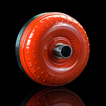

I lost my transmission in my truck so I was going to upgrade the torque converter when I replaced the tranny. I tow a heavy toy hauler (10-12,000 pounds) and was wanting suggestions on the best torque converter for my situation.

Unfortunately Circle D doesn't offer Converters for Allison transmissions.
Ive used stock converters from GM if its a stock engine.
If its got any type of tune that makes more power then i used these
