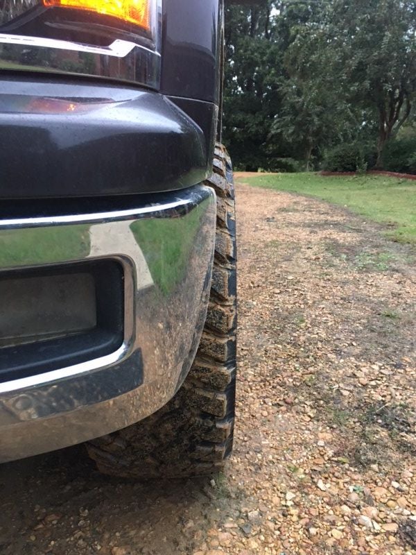

So I'm kind of stuck here. I bought some 22x12s and 33x12.5 MT tires and low and behold they rubbed on the front on bumper and fender. I have a 2.5 MotoFab leveling kit in front and nothing in the rear. I have seen other trucks with same size tires and only a leveling kit with no rubbing. Anyone suggest that NorCal mod or have any suggestions for me? I would prefer to keep these wheels but wife is pushing to return and stay with 20s.
