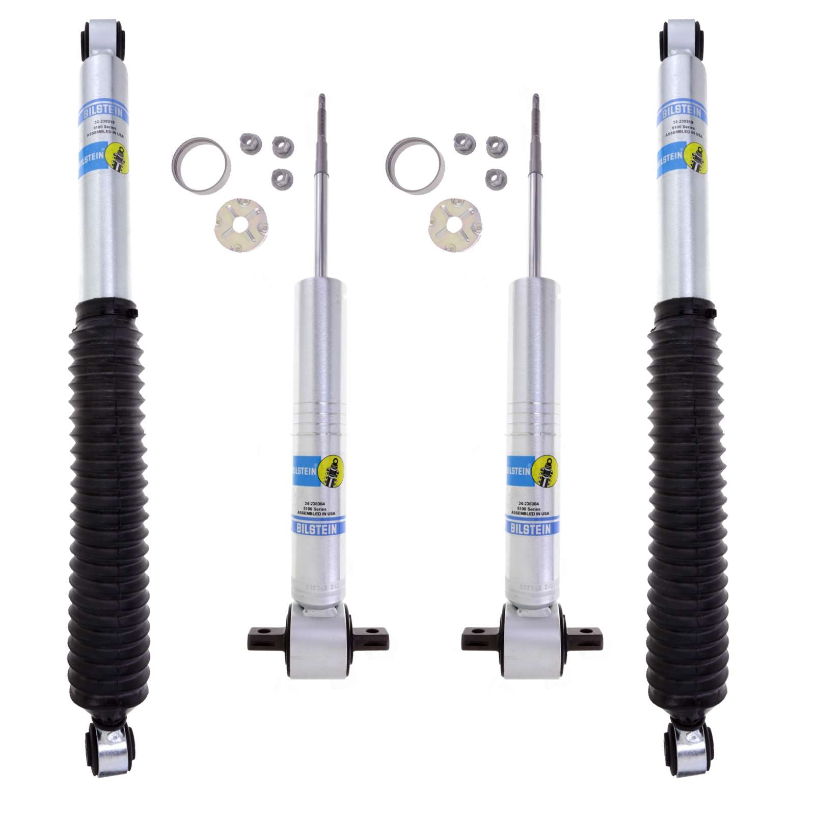

If you want the best riding kit, I would honestly skip the GM kit and look at:
Bilstein 5100's - $700 ish
Fox 2.0's - $1000 ish
Eibach Stg2 or stg2r - $1,200-$1,400 ish
Nothing wrong with the GM kit except it's still running crappy struts. If you are going to spend the money, id advise making it a worthwhile endeavor. Those GM extended CV's are nice, not needed, but a nice add if you wanted those too, now or later.

I think the vast majority here would agree with Bilstein as the best budget brand that is still great quality.

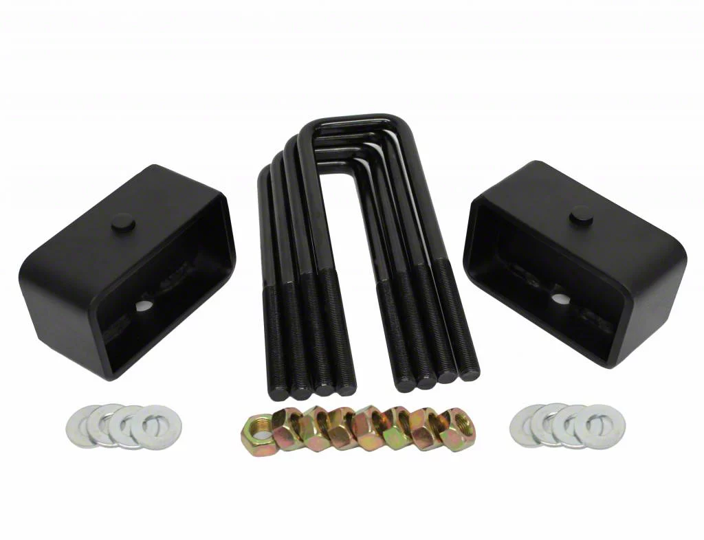

this option would be a little cheaper because the shop would utilize your stock springs. And then the rear lift blocks to lift the rear.
This will be around $650 plus installation. And you would get 2.5” in the front and 2” in the back and a lot better ride then stock.
Also you could find some tire take offs on OfferUp from new 2500/3500 sierras that wanted to go bigger tires right away. They are 34” compared to our oem size is 33”.
These are just the cheapest options like you asked for… should have no problems with this kit.

im a bilstein fan, but lots of people aren't hard enough for them. lmao
The day I trade my Fox’s for Bilstein is the day I’ll trade my wife in for a husband.
