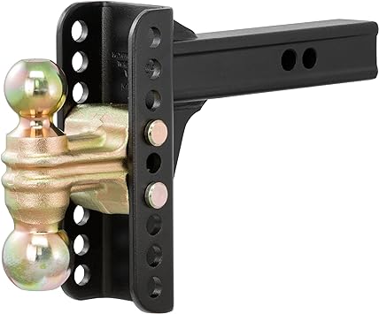

I have an adjustable hitch on the back of my 2500HD similar to this Curt so I can change the height properly for each different trailer that I have to pull.
