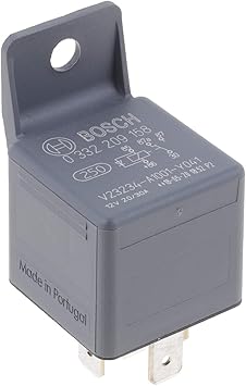

I made it simple to buy a Bosch relay with integrated diode protection. I'm connecting to the 300 mA RAP feed and 15A Power feed. I bought a pigtail harness too and inline fuse holders too.
Bosch 0332209158 Changeover Mini Relays - 5 Pins, 12 V, 20/30 A
