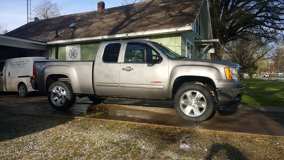

I have a 2001 Silverado 1500 4x4, it's already lifted with 6 inch RC suspension lift and has 35s on it. I'm planning to add a 3 inch body lift as well. But my question is, what are your thoughts on if I were to add a 1-2 inch torsion key lift as well and add Add-a-Leafs to the back? Would this work well or at least decently? Any advice on things I could do to make this work? I would replace torsion bars before doing the torsion key lift too.

yeah with the rc 6 you could crank the keys about an inch but wouldn't recommend.. got some pictures of this rig? what size tires and rims will you be running?

A 3" body lift if also going to make it look "skinny" tall, meaning too high of a body, and a likely ugly gap all around.

i think with the 20x10 -24 and 37s it might not look too skinny.. but i almost suggested another lift as well but most I am seeing are pretty pricey
