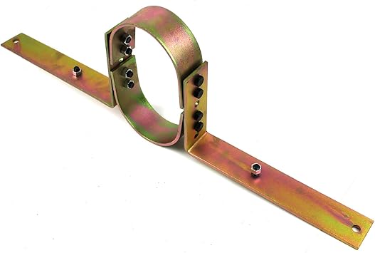

There is no guarantee that any new driveshaft will be indestructible. Take a medium to medium light steel chain that has welded links. Then cut it to the correct length, and then padlock it to the frame rails or some other strong material under the truck - near the front half of the drive shaft. If the front of the driveshaft comes off, it will make some racket - but it will not cause an accident.
There are plenty of brackets you can buy, but I just use a chain.
