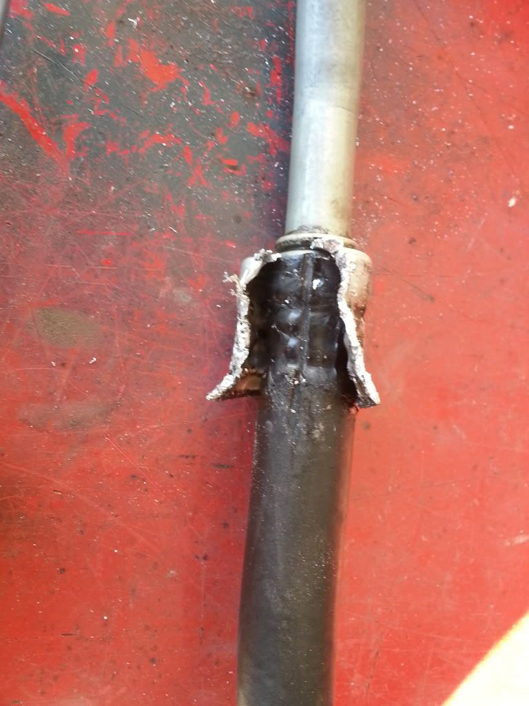

the bottom hose failed at the crimp

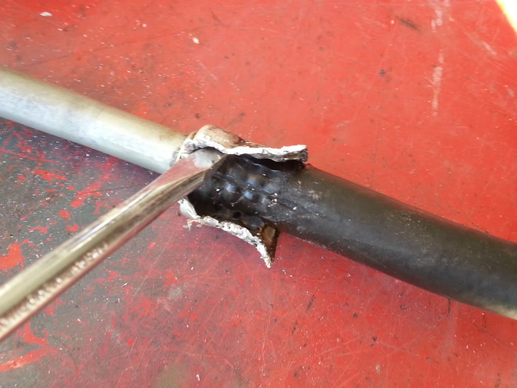

so i grabbed the cutting wheel and started to cut carefully making sure to only cut the crimp not the hose
With a flat blade screw driver i slowly pried the crimp open
once you break the crimp open it will just fall off
The hose just pulls out. When you are making the cuts make sure you dont cut the flares on the line.

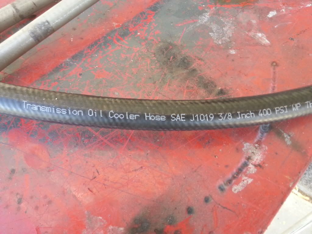

Well once i seen the way this was made i just went down to the local parts store and purchased some 3/8 transmission line. Its rated at 400 PSI . Thats more than enough .Considering your looking at 60 PSI max for the oil cooler. also picked up some clamps

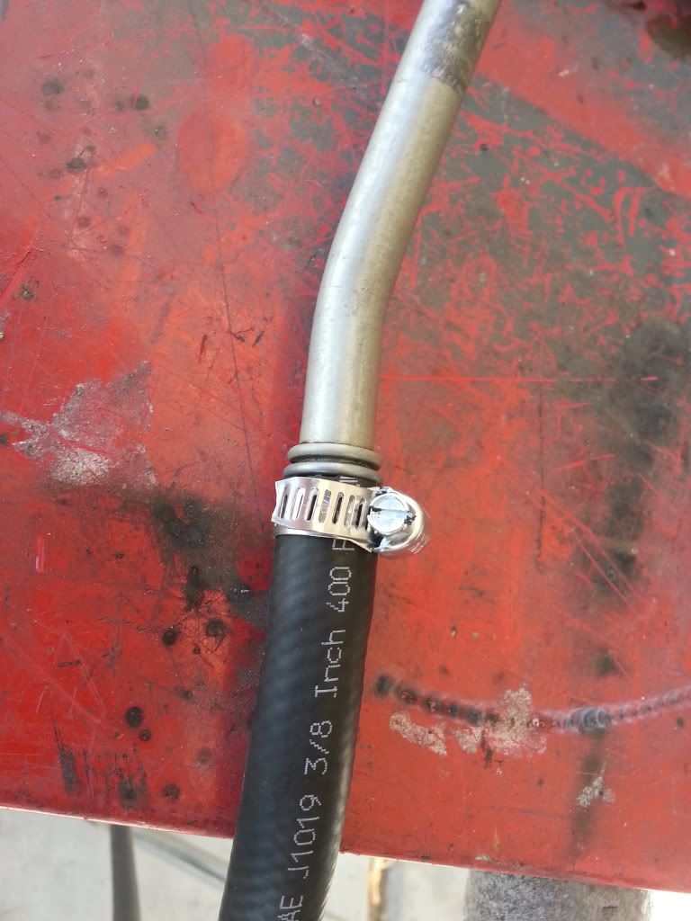

perfect fit

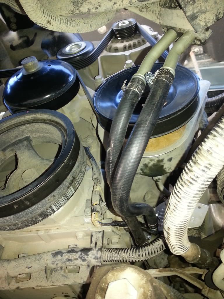

I mounted the lower half to the engine first . Then put the axle back up into its place. Next i installed the lines to the radiator . Once the hard lines are in i then ran the flexible hose. cut to fit them and clamp
Why did i do this instead of getting a new part?
Well if it leaks again i will NOT have to drop the axle all the other bull that goes with it. now all i have to do is loosen the clamps remove the hose and install some new hose line. $10 fix.
